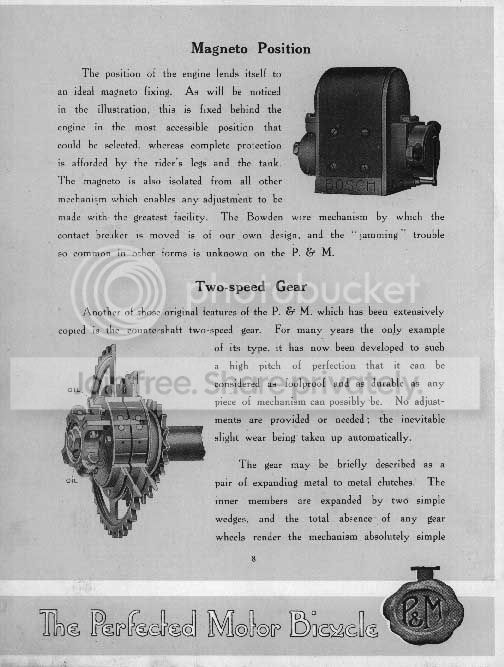

Here is what the P&M version looks like
I believe they are very similar ? This is what has lead me to ask the question here, what I really need to know at the moment is how much clearance is required between the internal drum (with the expanding rings) and the inside surface of the sprockets. I would think that despite and differences this would be the same/similar.
It may be of benefit to see the other systems so I would appreciate it if you could send those scans through to me. Please send them to me at sloper at tpg.com.au

Did you receive the Scott 2speed gear info? I wondered if you could open the .doc files?
I looked at a Scott 2speed unit today and agreed with the owner that the clearance between the expanding ring and the gear drum is minimal, probably 5 – 10 thou. Don’t hold us to it, stripping it down is the only way to get an accurate measurement.

Hi Richard
Yes I got the doc open, thank you very much, it has been a help.
Now that I see the Scott item it is obvious that it is quite different to the P&M unit. But then the P&M unit differed between different years as I found out when talking to other owners. Mine being ’14 has the expanding rings as part of the bronze hub whereas ’15 on and the scott have the expanding rings as seperate pieces.
That is good to hear about the minimal clearance, that is what I was thinking.
