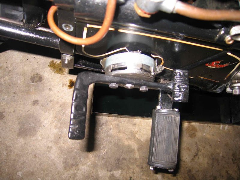

When Ken Lack had my gearbox I posed the same question. He thought that the tangs that make up the outer quick thread drum could be made less stiff by filing away at their inner corners. He did this for me while the mechanism was with him and it has made as big difference. I am trying to load a picture….
Are you going to Abbotsholme this year?
Best wishes,
James
Hi James,
Thanks for your picture
But, by making the drum less stiff you would still need to apply the same pressure with the band as before to lock it on the drum? Or am I thinking wrong here?
