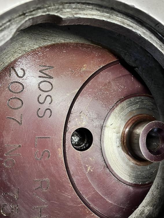

  • in reply to: Crankshaft center bolt engagement, length. Flying squirrel #36456
    chris wastell
    Aha, thanks, Dave. Sorry its a bit late but here’s a. photo of my crank which has just been knocked up with the Moss-supplied bolt tightened.
    in reply to: Crankshaft center bolt engagement, length. Flying squirrel #36445
    chris wastell
    I notice that Michael’s crank is marked “Right hand” I can’t remember. if the originals are so marked but Moss ones certainly are, hence my assumption that its one of Roger’s๐Ÿ™‚
    in reply to: Crankshaft center bolt engagement, length. Flying squirrel #36440
    chris wastell
    Sorry Dave, I have to disagree there if we are talking about the centre bolt. If it’s a Moss crank, that engagement is about right. I have mine apart at the moment and it’s the same.
