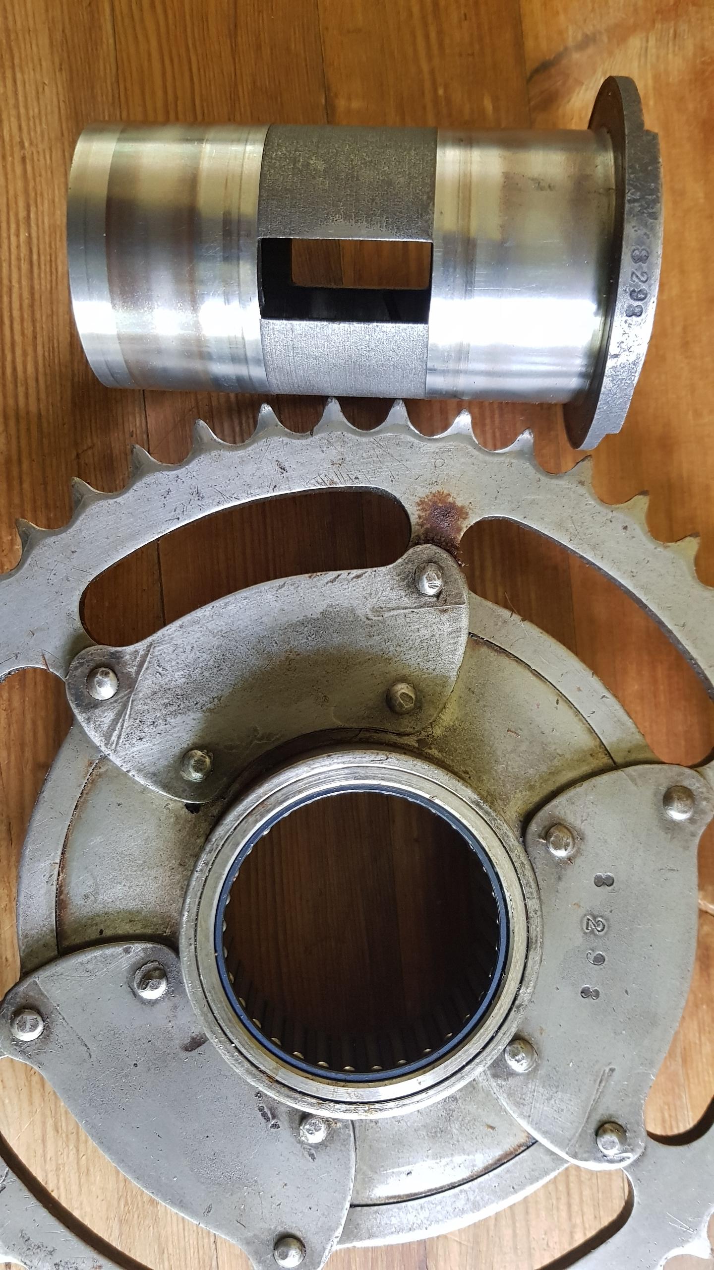

    in reply to: 2-speed gear assembly #33513
    Ian Parsons
    When I overhauled my 2 speed gear I used a NK 47/20 needle roller race for the drum bearings which is 29 x 38 x 20. I think I may have had the hub ground to suit. I also used part of a FT 7/8″ thrust race.2 speed drum bearing
